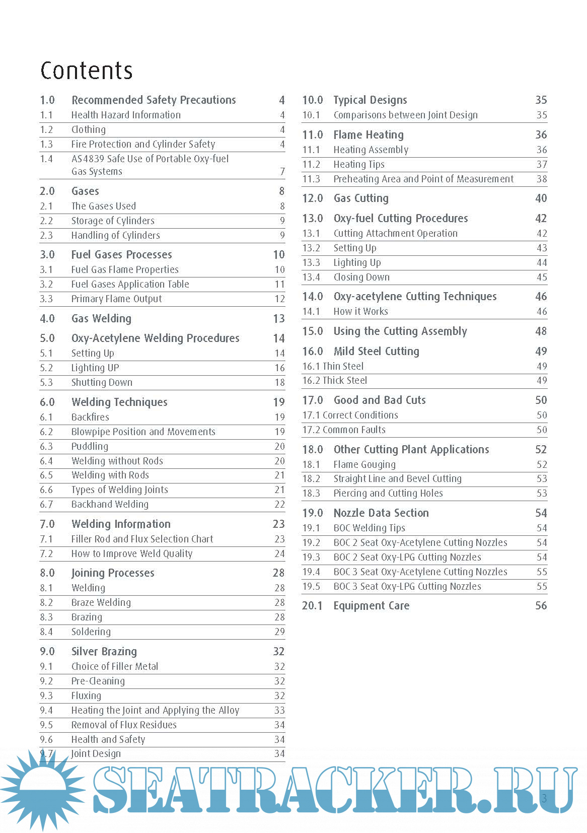

Guidelines for welding and cutting
Year: 2012
Author: BOC
Pages count: 60
Description: The oxy-fuel process utilizes a flame to generate heat for cutting, welding and brazing.
Care must be taken to avoid the contact of the flame with any combustible substances.
A firebrick top workbench is recommended for cutting on.
Ensure that you have adequate ventilation to dissipate fumes in work locations.
