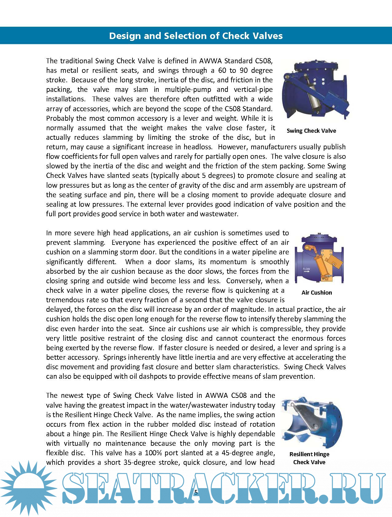

just as important, the valve should protect the pumping system and piping from pressure
surges caused by sudden closure. Every pump station designer has witnessed check valve slam,
which is caused by the sudden stoppage of reverse flow through a closing check valve. To
prevent slam, an automatic check valve must either close very quickly or close slowly by using
oil dashpot devices.
