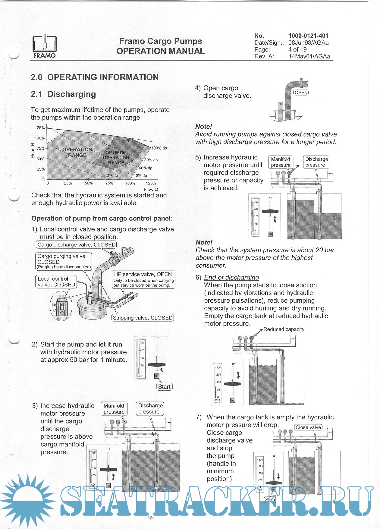

For maximum efficiency, operate as few power packs as possible, maintaining the required oil flow.
Hydraulic system pressure should be kept to a minimum above the requirements to the highest consumer.
Operation of the pumps to be within the capacity range.
In case of low discharge pressure, observe for abnormal noise and vibration. Reduce the hydraulic pressure until stable condition is obtained.
