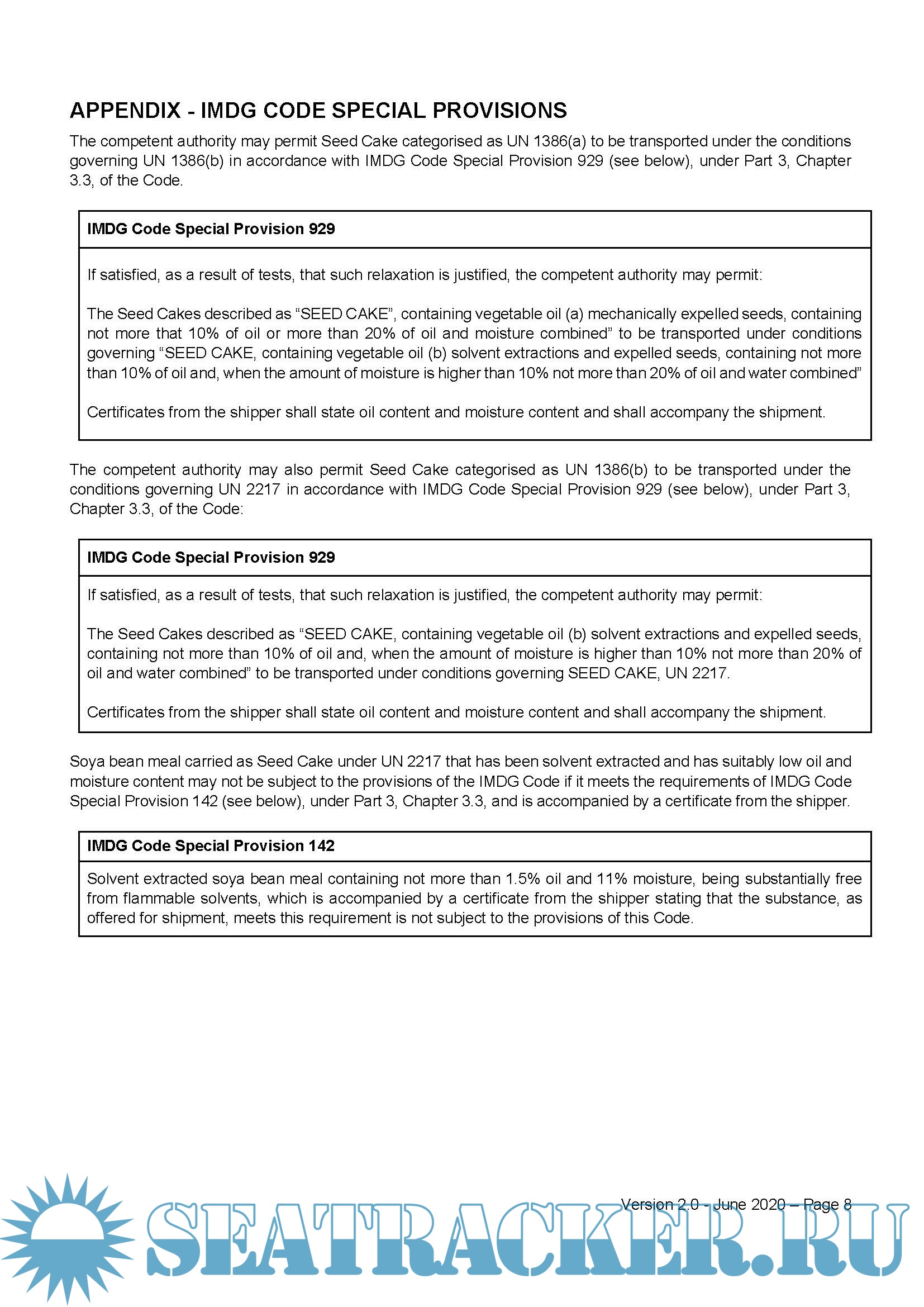

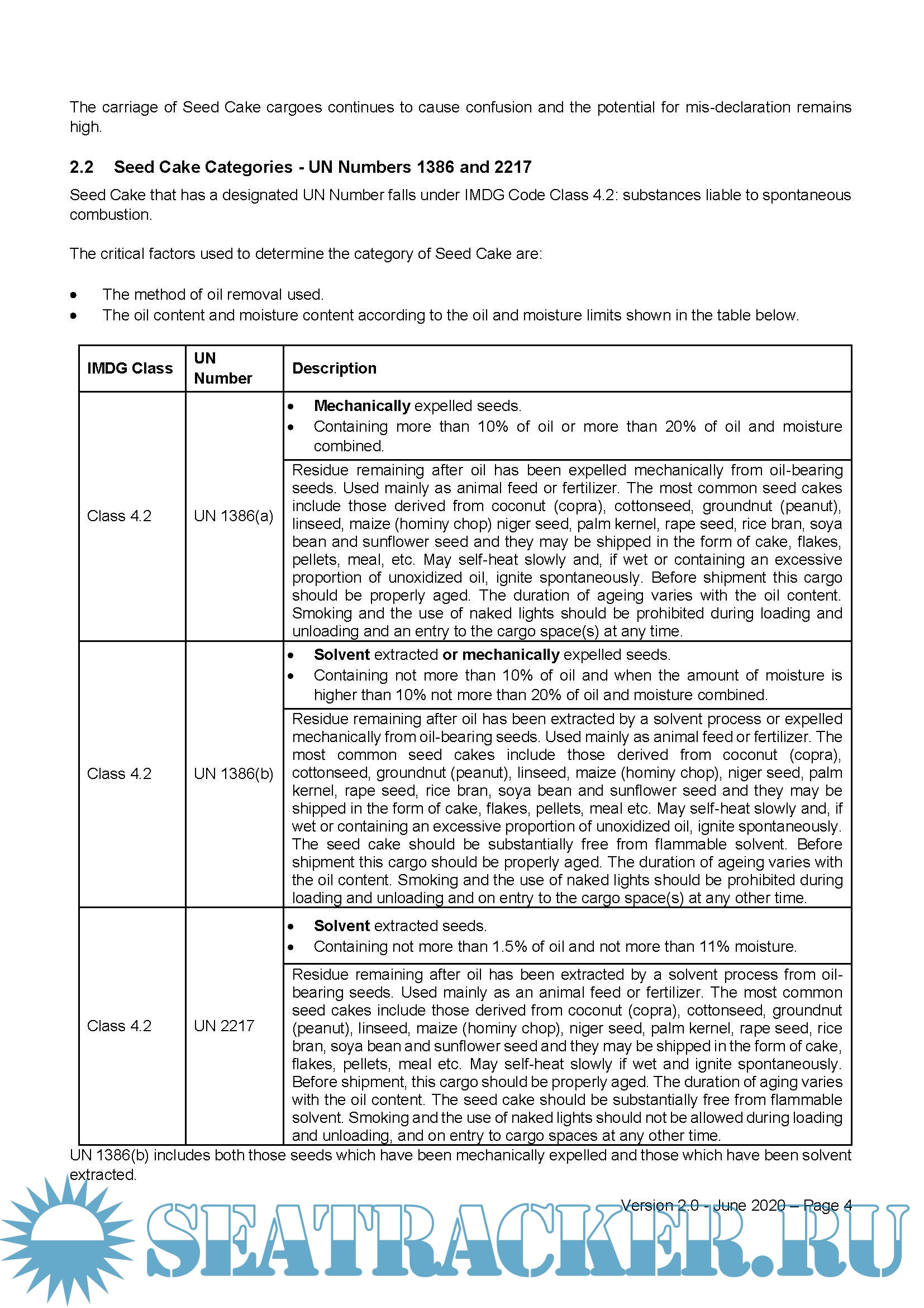

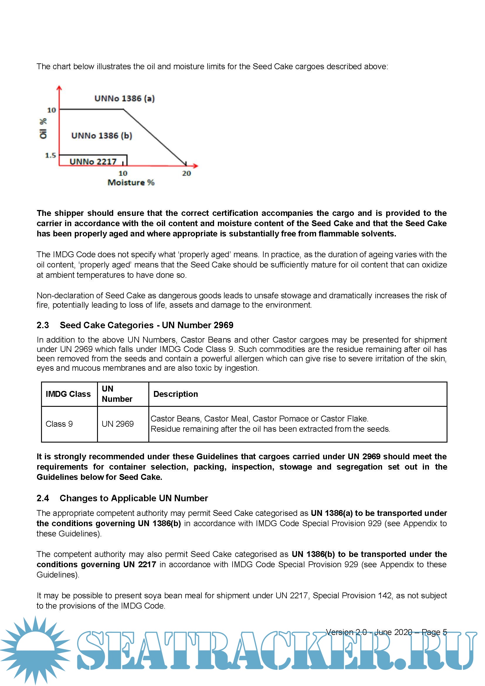

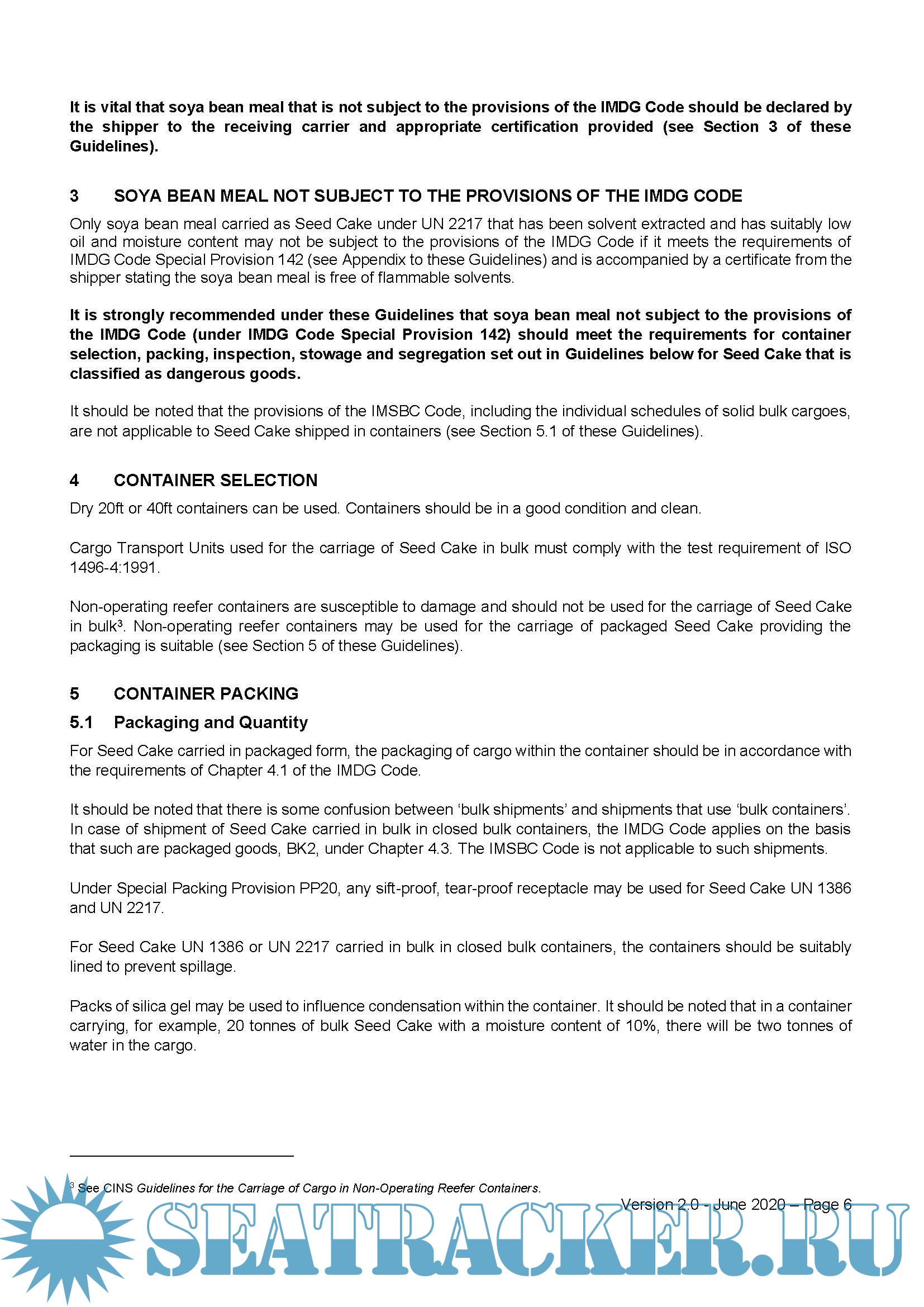

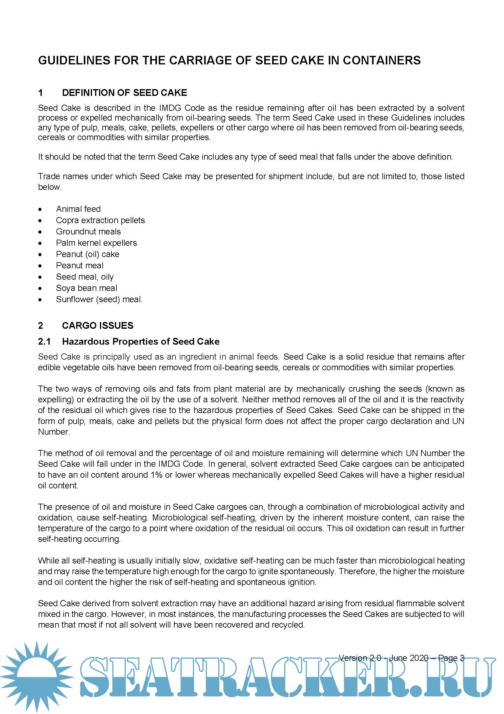

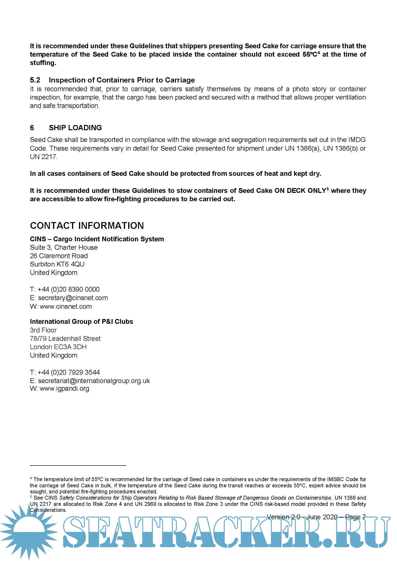

Year: 2020 Language: english Author: CINS Genre: Guide Format: PDF Quality: eBook Pages count: 8 Description: Seed Cake is the term used for pulp, meals, cake, pellets, expellers and other similar cargo where edible vegetable oils have been removed from oil-bearing seeds, cereals or commodities with similar properties1. These Guidelines for the carriage of Seed Cake in containers have been prepared by Working Groups of CINS (Cargo Incident Notification System). The practices set out in this document are intended to improve safety during the carriage of Seed Cake and to ensure that it is properly declared, packaged and carried. Seed Cake shall be transported in compliance with the requirements set out in the International Maritime Dangerous Goods Code (IMDG Code)2. The practices set out below include selected provisions from the IMDG Code plus additional precautions to enhance its safe carriage.
