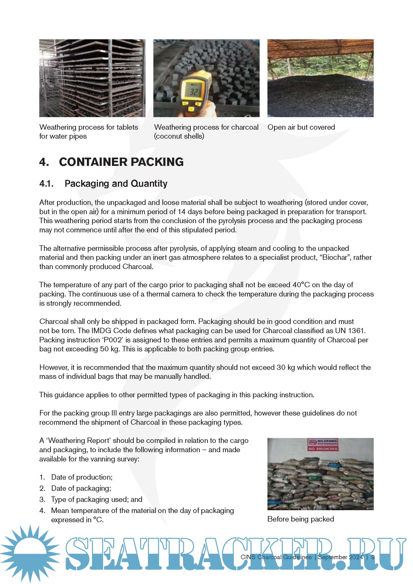

The practices set out in this document are intended to improve safety during the carriage of Charcoal and
to ensure that it is properly prepared, declared, packaged and carried.

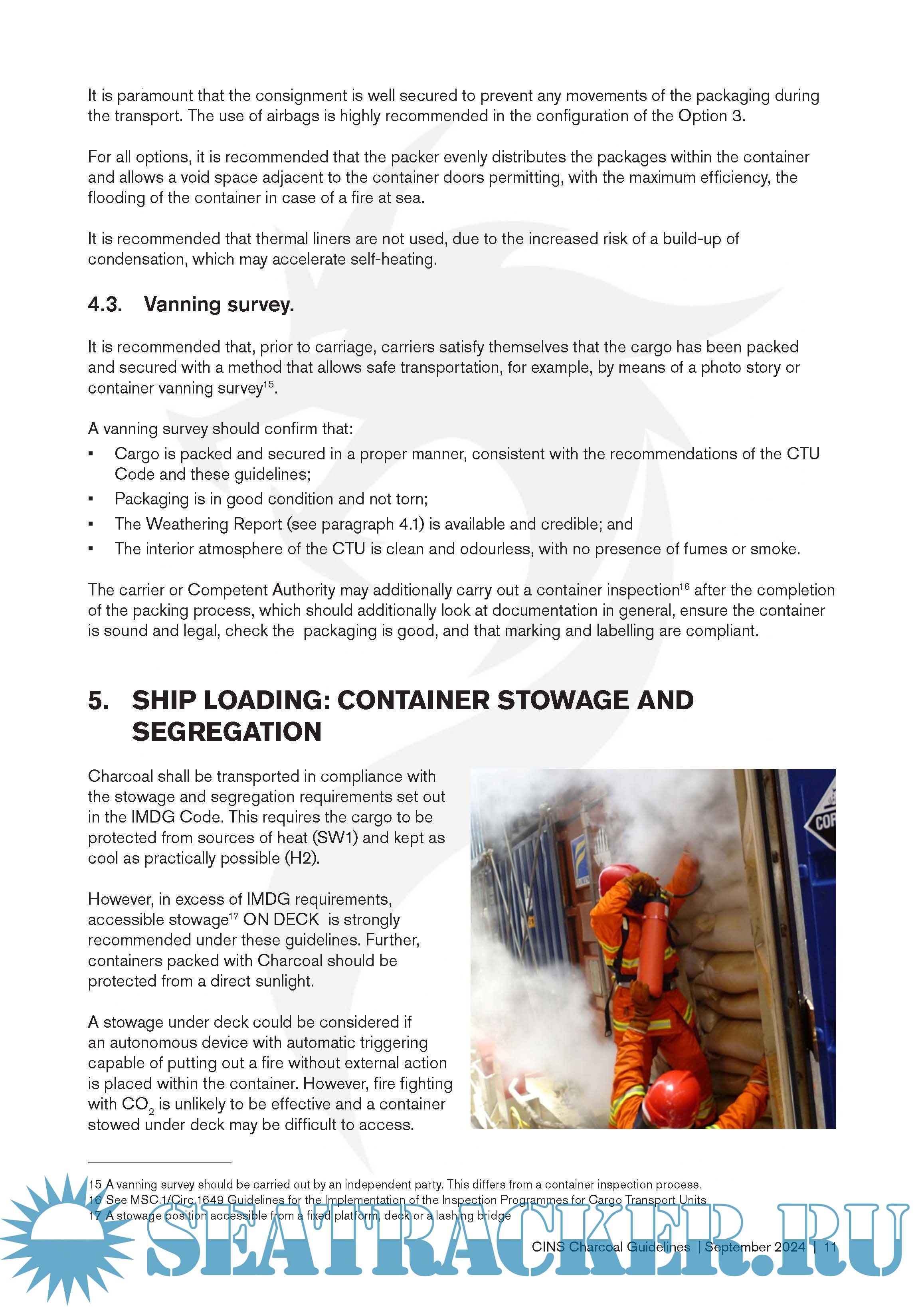

Charcoal shall be transported in compliance with the requirements set out in the International Maritime
Dangerous Goods Code (IMDG Code)2. However, the practices set out below include selected
provisions from the IMDG Code plus additional precautions to enhance its safe carriage.
