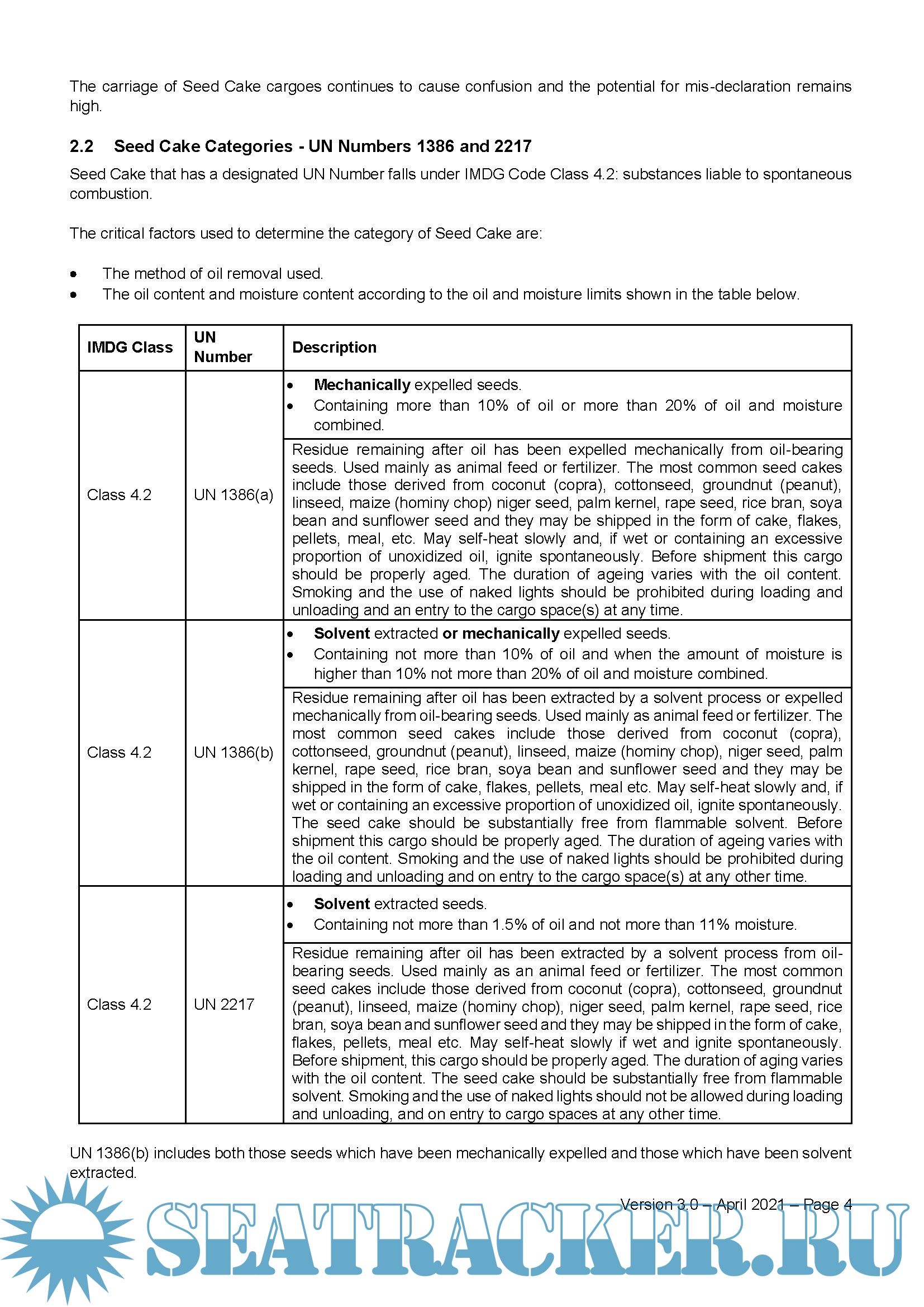

The carriage of Seed Cake cargoes continues to cause confusion and the potential for undeclared or misdeclared cargo remains high - with the consequent risk of fire on board container ships. “Seed Cake” is the term used for pulp, cake, pellets, expellers or other cargo where oil has been removed from oil-bearing seeds, cereals or commodities with similar properties, including all such types of seed meal. It is principally used as an ingredient in animal feeds.

Definition Of Seed Cake
Cargo Issues
