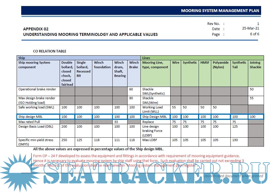

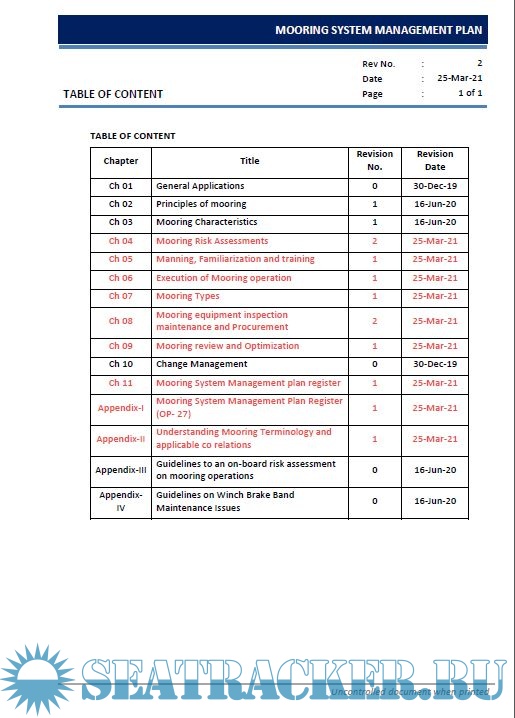

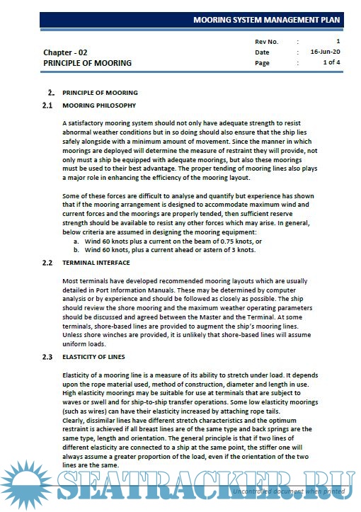

Description: The Mooring System Management Plan (MSMP) has been created to help operator ensure the mooring system is inspected, maintained and operated in accordance with the original design basis. It will contain information that can be available to anyone on the ship who needs to review it.
The objective for the MSMP is to ensure that all assessed risks are effectively managed through the design and operation of the mooring system. Its aim is to ensure that during mooring operations, no harm comes to ship or terminal staff or damage to the ship or terminal/facility it is interfacing with and that the mooring system meets applicable regulations, codes and recommended practice.
Ship operators and ship builders should collaborate from the earliest stage in the ship's design to ensure risks are reduced through mooring design and risk reviews.
Collectively mooring system management plan will achieve the objective through establishing:
• Records of mooring equipment, including all permanent and loose items and its 'as built' design basis, to be retained by the ship throughout its lifecycle (the Mooring system management plan register - MSMPR).
• Information required to be maintained as an up-to-date record of the ship's mooring equipment technical status.
• Operating procedures and risk assessments that ensure the safety and occupational health and wellbeing of the ship's staff when using mooring equipment or operating in the mooring workspace.
