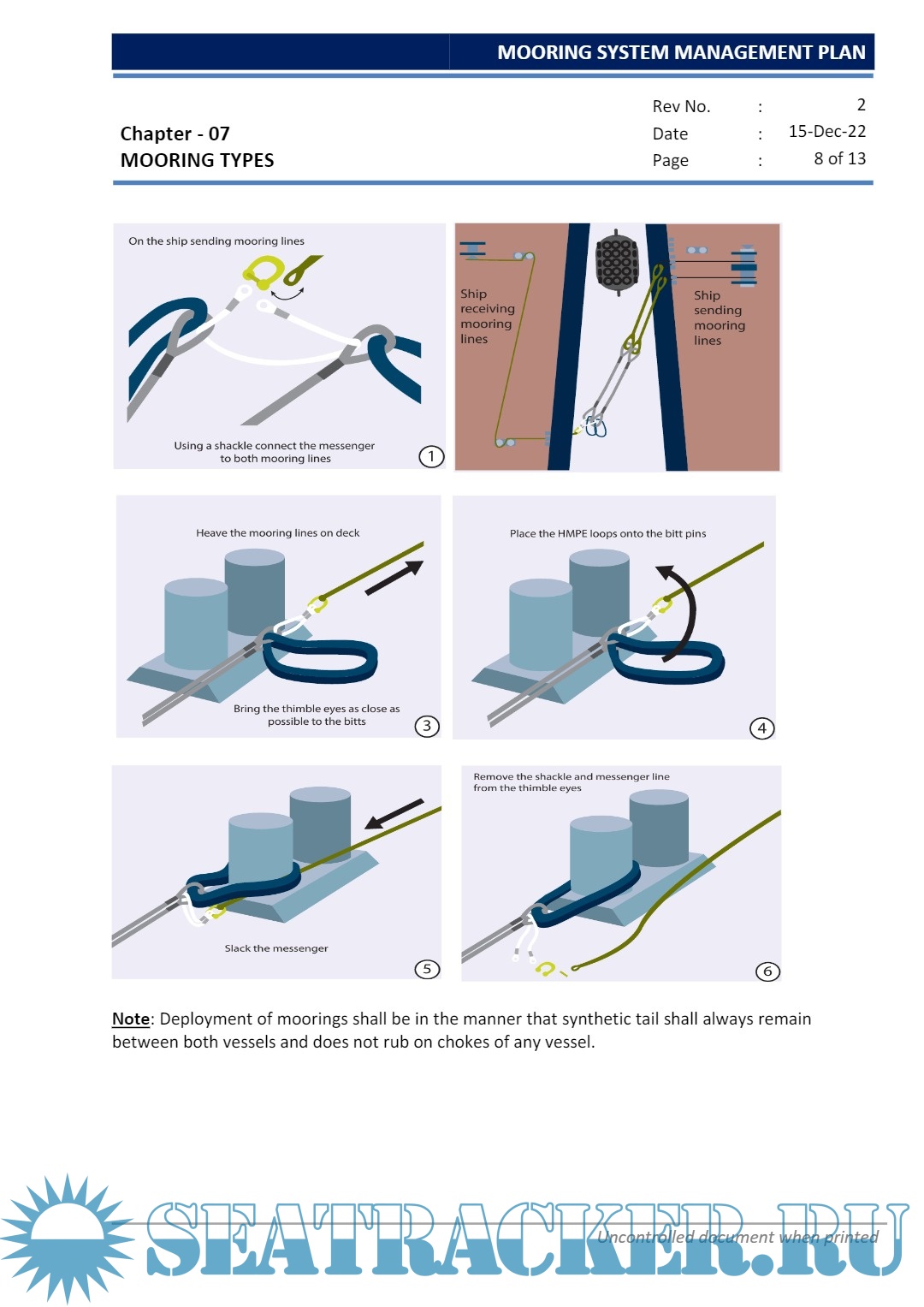

Mooring System Management Plan (MSMP)
Year: 2022
Author: Synergy Maritime Pvt. Ltd.
Edition: I | December
Pages count: 117
Description: The Mooring System Management Plan (MSMP) has been created to help operator ensure the mooring system is inspected, maintained and operated in accordance with the original design basis. It will contain information that can be available to anyone on the ship who needs to review it.The objective for the MSMP is to ensure that all assessed risks are effectively managed through the design and operation of the mooring system. Its aim is toensure that during mooring operations, no harm comes to ship or terminal staff or damage to the ship or terminal/facility it is interfacing with and that the mooring system meets applicable regulations, codes and recommended practice.
