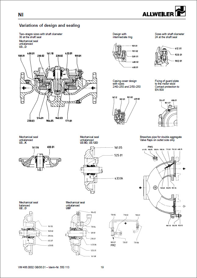

Volute Casing Centrifugal Pumps Retain Series NI / Operating and Maintenance Instructions
Year: 2001
Author: ALLWEILER
Genre: Operating and Maintenance Instructions
Publisher: ALLWEILER
Series: VM 466.0002 GB/06.01 – Ident–Nr. 550 113
Quality: OCR without errors
Number of pages: 20
Description: Operating and Maintenance Instructions VM No.: 466.0002 GB / Edition: 06.01/ Ident No.: 550 113
Operating data, dimensions and other additional information can be found in the order–specific part of the
documentation.
These Operating and Maintenance Instructions contain information from the pump manufacturer. They may need
to be supplemented by instructions of the operator company for its personnel.
These instructions do not take account of specific information relating to operation and maintenance of the process
plant into which the pump is integrated.
Such information can only be given by the persons responsible for construction and planning of the plant (plant
manufacturer).
Such specific instructions relating to operation and maintenance of the process plant into which the pump is
integrated have priority over the instructions of the pump manufacturer.
The plant manufacturer must on principle observe the limits of use! Refer to the operating instructions of the plant manufacturer!

4 Description / Principle design of the pump
The pictorial presentation may not correspond with the pump supplied.
The actual design will be stated in the specific order documents.
Volute casing Impeller
Motor stool
Plug–in shaft
Contact protection
to EN 809
Shaft seal space
Earthing connection to EN 809
must be attached by the customer
Motor with locating
bearing at the driving
side
NI
