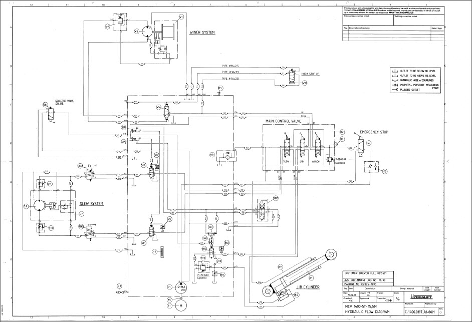

H MAIN SYSTEM
HI 14431 MAIN PUMP 1 PA 1911 R3B26A
H2 MAIN CONTROL VALVE 1 VB 1107 NDN P-175, LH ASSY
H3 11250 HYDR. OIL FILTER 1 TTF-170
H4 11259 FILTER ELEMENT FOR H3 1 TXX4-10
H5 15058 HYDR. OIL FILLING ARR. 1 EF4-50HY 2" BSP
H6 15049 . HYDR. OIL LEVEL INDICATOR 1 UC-FL-213
H7 | DRAIN VALVE 1 51-1" w/PLUG
H8 11993 MINIMESS PRESSURE POINT 1 ST-04, R 1/4" BSP 316
Hll RUBBER SEAL FOR PUMP 1 2mm NEOPRENE
H12 STUD BOLTS FOR PUMP w/NUT 4 M12x30, DIN 938-8.8
H13 15061 INITIAL SERVO PRESS .VALVE 1 VDR R16-C2
H27 14403 EMERGENCY STOP VALVE 1 SSV 09x9L Hy
(P-K)PK-1400-66
DESCRIPTION QTY. SPECIFICATION
SLEW SYSTEM
SLEW RING 1
BOLTS FOR SLEW RING, 54
OUTER RING. TYPE 1.
BOLTS FOR SLEW RING, 6
OUTER RING. TYPE 2.
BOLTS FOR SLEW RIMS, 60
INNER RING
NUT F/BOLT IN SLEW RING 54
WASHER, HARDENED 174
SLEW GEAR BOX 1
BOLT FOR GEARBOX MOUNT. 16
HYDR. SLEW MOTOR 1
STUDBOLT FOR SLEWMOTOR/ GEAR w/NUT 4
SLEW RESTRICTOR VALVE 2
SLEW STOP VALVE 1
SLEW STOP VALVE 1
SLEW STOP VALVE 1
RED CAP F/SLEW RING BOLT 54 RED CAP F/MOUNTING BOLTS SLEWSEAR 16
SLEW STOP ARRANGEMENT 1
PILOT OPER. CHECK VALVE SLEW LEFT 1
PILOT OPER. CHECK VALVE SLEW RIGHT 1
JIB ANGLE OVERRIDE VALVE 1 SLEW STOP VALVE 1
SLEW STOP VALVE 1
BLEEDER VALVE 2
062.30.1400.Oil.41.1504 UNBRAKO M20xl50, U-130 DIN 912-12.9 UNBRAKO M20xl00, U-130 DIN 912-12.9 UNBRAKO M20xl50, U-130 DIN 912-12.9 M20, DIN 6330-10 039/021 x 6
S385 (m=12 z=12 c=0,5 b=88) 1=146,8 SAE C UNBRAKO Ml6x50, DIN 912-12.9 MC 2208 C5B25D
Ml2x30, DIN 938-8.8 VDR R16-C2 VB 1006N w/HPOO DSV 06x26L DSV 06x26L DBI DOT NO.:50
DBI DOT NO. :41 DRW.NO.:
RH 2
RH 2
TZ3-1 / HL 06.297 SSV 09x31S SSV 09x31S FT 1251/2-01-1/4"
(P-K)PK-1400-66
POS.NO. ART.NO. DESCRIPTION QTY. SPECIFICATION
JIB CYLINDER 1
CYLINDER VALVE 1
BEARING FOR CYLINDER 2
CYLINDER BOLT 2
LOCK PLATE F/CYL. BOLT 2 SPACER RING F/CYL INDER BEARING 4
LOCK BOLT FOR CYL. BOLT 2 BOLT w/HOLE 1/4” BSP F/B4 1 BOLT w/LUB. NIPPLE FOR CYLINDER BOLT 2
HYDR. PIPE ON CYLINDER 1 PRESSURE REDUCTION VALVE 1 BLEEDER VALVE 1
CYLINDER VALVE HOUSE 1
MINIMESS PRESSURE POINT 1 SELECTOR VALVE 1
CHECK VALVE, PILOT OPER. 1 SHUTTLE VALVE 1
BLEEDER VALVE 1
C10SS 0225/0l3Oxl835-TB,
CL-CL=2574
BM 131347
GE 120 D0-2RS
DRW. NO: C. 1400.0150. A2.7008
DRW.NO: C. 1400.0150 .A2.7008
DRW. NO: C. 1400.0150. A2.7008 M3Gx80, DIN 933-8.8 M3 0x50
M30x50, DIN 933-8.8, 1/4" BSP 025x3x2000 BM 113574 FT 1251/2-01-1/4"
BM 131856-1
ST04 Rl/4" BSP 316
HZ 3-1-1/4"
RH 2
VFC-NC / Rl/4 FT 1251/2-01-1/4"
(P-K)PK-1400-66

W WINCH SYSTEM
W1 16791 WINCH GEARBOX 1 W171 SAE C i=31,36
W2 BOLT FOR WINCH GEAR
TO FOUNDATION 12 UNBRAKO Ml2x45, DIN 912-12.9
W3 HYDR. WINCH MOTOR 1 MC 2210 C5B25D
m 16240 STUDBOLT w/NUT FOR
HYDR. MOTOR/GEAR 4 Ml2x30, DIN 938-8.8
W5 (B) WINCH ARRANGEMENT 1 DRW.NO.: HLR 689-10
W6 BOLT FOR WINCH TO JIB 10 M20x80, DIN 931-8.8
W7 NUT FOR W6 20 M20, DIN 934-8
W9 BOLT FOR GEARBOX/DRUM 12 UNBRAKO Ml2x45, DIN 912-12.9
W15 14422 LOAD HOLDING VALVE 1 VBSO-SE-NA 05.41.62-03-04-35
W20 WIRE 84m 0l3mn, DYFORM 18x7, GALVANIZED
W21 CARGO HOOK w/FRAMLOCK 1 BRISAFE 6 / FRAMLOCK NO.16
W22 (B) CARHO HOOK BLOCK 1 SWL 5 TONS
W23 SHACKLE 1 SWL 3 TONS
W25 (B) WIRE SHEAVE 2 12"
W26 (B) BEARING FOR WIRESHEAVE 4
W27 (B) BOLT FOR WIRESHEAVE 2 DRW.NO.: HLR 389.110
W28 (B) LOCK BOLT FOR MAIN BOLT
(W27) 2 Ml2x40, DIN 933-8.8
VJ29 (B) LOCK PLATE t
FOR MAIN BOLT (W27) 2 DRW.NO.: HLR 389.110
W31 (B) DISTANCE BOLT FOR
WIRE SHEAVE BRACKET 3 Ml6x120, DIN 931-8.8
W32 (B) NUT FOR DISTANCE BOLT 3 M16, DIN 934-8
W33 10038 HOOK STOP UP ARRANGEMENT 1 BM 132027
W34 WIRE FOR HOOK STOP ARR. 2 06mn, GALV. L=0,7m
W36 SELECTOR VALVE FOR
HOOK STOP UP 1 SSV 09x25S / HL 06.354
( P-K) PK-1400-66

POS.NO. ART.NO. DESCRIPTION E EL. SYSTEM
QTY. SPECIFICATION
El
E2
E3
E12
E13
EL. MOTOR FOR MAIN PUMP
EL. STARTER BOX 1
REMOTE START/STOP BOX 1
MOUNTING BOLT F/EL. MOTOR 4 NUT FOR MOUNTING BOLTS 4
BROOK 7-UD 180LD, 37kW (S6-40%), 440V/60Hz/3ph HEATER : 220V/60Hz/lph
D.O.L.
XAL-B371
Ml6x60, DIN 933-8.8 M16, DIN 934-8
M MOUNTING DETAILS
Ml 16992 NAME PLATE w/SCREWS 2 HYDRALIFT
M2 17896 NAME PLATE w/SCREWS 1 SWL 5T-15,5M
M3 PIPE F/HOOK STOP 48m 016x2,5 DIN 1291C
M4 PIPE CLAMP 56 GS 0l6mn
M5 STRAIGHT COUPLING 15 HBTXS 16
M7 TUBE REDUCER 3 TRBTXS16-10
M9-1 BOLT F/HATCH 16 M12x20, DIN 933-8.8
M9-2 BOLT, STUD w/NUT 12 M12x25, DIN 938-8.8
Mll-1 PIPE F/REM3TE LUB. 24m 016 w/OOUPL./CLAMPS
Mll-2 PIPE F/REMDTE LUB. 3m 010 w/COUPL. /CLAMPS
M40 NAME PLATE 1 WINCH UP/DOWN
M41 NAME PLATE 1 JIB UP/DCWN
M42 NAME PLATE 1 SLEW RIGHT/LEFT
M43 NAME PLATE 1 MACHINE NO.:
me NAME PLATE 1 EMERGENCY STOP
(P-K)PK-1400-66
This document and ail information and data disclosed herein or herewith are the confidential and proprietary
property of MARITIME HYDRAULICS and are not to be used, reproduced or disclosed in whole or in part
by or to anyone without the written permission of MARITIME HYDRAULICS.
Tolerances except as noted Welding except as noted
Rev. Description of revision Date / Sign.
1 CRANE FOUNDATION TO 8E WELDED TO SUBSTRUCTURE PRIOR TO INSTALLING CRANE WITH SLEW BEARING
2. SLEW BEARING SUPPORT FLANGE HAS TO BE MEASURED FOR
FLATNESS AFTER ALL WELDING HAS BEEN COMPLETED AND STRUCTURE RETURNED TO NORMAL TEMPERATURE.
3 FOR OPTIMAL SLEW BEARING LIFE THE FLATNESS HAS TO BE KEPT WITHIN GIVEN TOLERANCES.
CRANE w/SLEW BEARING
TORQUE = 62Kpffi USE SPECIFIED BOLTS AND WASHERS
STATIC KIPMOMENT AT SWL : 97 TM
STATIC KIPMOMENT AT TEST LOAD ■117 TM
SLEW BRAKE MOMENT •21,1 TM
CRANE WEIGHT :~8 T
10
PORT CRANE
CUSTOMER
DAEWOO HULL NO.:5501
A/S NOR-MARINE JOB NO 71 /90 MACHINE NO K2826-1890
A/S HYDRALIFT
PAGE 1 OF 6
PARTS LIST
Revised;08.05.90 TL/rbj
DRW. REF. :C. 1400.0117.Al-67
C. 1400.0117.A1-67H
CRANE TYPE : MCV 1400-5T-15,5M MACHINE NO.: K2826-1890
(B) BOHXER SOPPLT (DAEWOO)
H MAIN SYSHM
H6 15049 HYDR. OIL LEVEL INDICATOR 1 UC-FL-213
H7 DRAIN VALVE 1 51-1" w/PLUG
H12 STUD BOLTS FOR PUMP w/NUT 4 Ml2x30, DIN 938-8.8
H27 14403 EMERGENCY’ STOP VALVE 1 SSV 09x9L Hy
(P-K)PK-1400-67
2
QTY. SPECIFICATION
SUESf SYSTEM
51 13905 SLEW RING 1
52 BOLTS FOR SLEW RING, 54
OUTER RING. TYPE 1.
53 BOLTS FOR SLEW RING, 6
OUTER RING. TYPE 2.
54 BOLTS FOR SLEW RING, 60
INNER RING
55 NUT F/BOLT IN SLEW RING 54
56 WASHER, HARDENED 174
57 SLEW GEAR BOX 1
58 BOLT FOR GEARBOX MOUNT. 16
59 18001 HYDR. SLEW MOTOR 1
S10 15240 STUDBOLT FOR SLEWMOTOR/
GEAR w/NUT 4
SLEW STOP VALVE 1
SLEW STOP VALVE 1
SLEW STOP VALVE 1
514 14376 RED CAP F/MOUNTING
i
BOLTS SLEWGEAR 16
515 (B) SLEW STOP ARRANGEMENT 1
S17 PILOT OPER. CHECK VALVE
SLEW LEFT 1
517 PILOT OPER. CHECK VALVE
SLEW RIGHT 1
518 JIB ANGLE OVERRIDE VALVE 1
560 11212 SLEW STOP VALVE 1
561 11212 SLEW STOP VALVE 1
562 18975 BLEEDER VALVE 2
Sll 15061 S12-1
S12-2 15902
S12-3 15902
S13 .14370
062.30.1400.011.41.1504 UNBRAKO M20xl50, U-130 DIN 912-12.9 UNBRAKO M20xl00, U-130 DIN 912-12.9 UNBRAKO M20xl50, U-130 DIN 912-12.9 M20, DIN 6330-10 039/021 x 6
S385 (m=12 z=12 0=0,5 b=88) i=146,8 SAE C
M12x30, DIN 938-8.8 VDR R16-C2 VB 1006N w/HPCO DSV 06x26L DSV 06x26L DBI DUT NO. :50
DBI DUT NO. :41 DRW.NO.:
RH 2 RH 2
TZ3-1 / HL 06.297 SSV 09x3IS SSV 09x3IS FT 1251/2-01-1/4H
(P-K)PK-1400-67
3
PGS.NO. ART.NO. DESCRIPTION
QTY. SPECIFICATION
B
JIB CHJUDER SYSTEM
B1 JIB CYLINDER 1
B2 15062 CYLINDER VALVE 1
B3 BEARING FOR CYLINDER 2
B4 (B) CYLINDER BOLT 2
B5 (B) LOCK PLATE F/CYL. BOLT 2
B6 (B) SPACER RING F/CYLINDER
BEARING 4
B7 LOCK BOLT FOR CYL. BOLT 2
B8-1 15865 BOLT w/HOLE 1/4" BSP F/B4 1
B8-2 BOLT w/LUB. NIPPLE FOR
CYLINDER BOLT 2
B9 HYDR. PIPE ON CYLINDER
BIO 15063 PRESSURE REDUCTION VALVE
Bll 18975 BLEEDER VALVE
B13 16790 CYLINDER VALVE HOUSE
B18 11993 MINIMESS PRESSURE POINT
B22 10182 SELECTOR VALVE
B60 14961 CHECK VALVE, PILOT OPER.
B61 15859 SHUTTLE VALVE
B62 18975 BLEEDER VALVE
CL-CL=2574
BM 131347
GE 120 DO-2RS
DRW. NO: C. 1400.0150 .A2.7008
DRW.NO:C. 1400.0150.A2.7008
DRW.NO:C.1400.0150. A2.7008 M30x80, DIN 933-8.8 M30x50
025x3x2000
BM 113574
FT 12 51/2-01-1/411
BM 131856-1
ST04 Rl/411 BSP 316
HZ 3-1-1/4"
RH 2
YFC-NC / Rl/4 FT 1251/2-01-1/4"
i
(P-K)PK-1400-67
W WINCH SYSTEM
W1 16791 WINCH GEARBOX 1 W171 SAE C 1=31,36
TO FOUNDATION 12 UNBRAKO M12x45, DIN 912-12.9
W4 16240 STUDBOLT w/NUT FOR
HYDR. MOTOR/GEAR 4 • Ml2x30, DIN 938-8.8
W5 (B) WINCH ARRANGEMENT 1 DRW.NO.: HLR 689-9
W20 WIRE 84m 0l3mm, DYFORM 18x7, GALVANIZED
W21 CARGO HOOK w/FRAMLOCK 1 BRISAFE 6 / FRAMLOCK NO. 16
(W27) 2 M12x40, DIN 933-8.8
W29 (B) LOCK PLATE
W34 WIRE FOR HOOK STOP ARR. 2 06mm, GALV. L=0,7m
(P-K)PK-1400-67
5
K MECHANICAL COMPONENTS
Kl (B) CRANE BASE 1 DRW.NO. :C. 1400.0150.Al. 1011
K2 (B) CRANE KING 1 DRW.NO. :C. 1400.0150.Al.2015
K3 (B) CRANE JIB 1 DRW.NO. :C. 1400.0117.Al.3026
K5 14391 FLEXIBLE COUPLING 1 RADAFLEX 300-16
K6 13943 JIB BEARING 2 GE 120 DO
K7 14501 SEAL RING FOR JIB BEARING 2 V 220A
K8 (B) JIB BOLT 1 DRW. :C. 1400.0150.A2.7007
K9 (B) LOCK PLATE FOR JIB BOLT 1 DRW. :C.1400.0150.A2.7008
K10 LOCK BOLT FOR LOCK PLATE 1 M30x80, DIN 933-8.8
Kll (B) BOLT FOR JIB BOLT
w/LUB. NIPPLE 1 M30x50, DIN 933-4.6
K16 (B) SET SCREW FOR
COUPLING PARTS 2 M8xl5, STAINLESS
K17 (B) LUB. NIPPLE 2 PT 1/8" (JIS P1575)
K18 PLUG 1 504-6
K19 PACKING FOR INSP. HATCH
KING (NO. 1) 1 2mm NEOPRENE, 2x0620
K20 PACKING FOR INSP. HATCH
KING (NO.2) 1 2mm NEOPRENE, 2x115x200
K23 PACKING FOR INSPECTION
HATCH BASE 1 2mm NEOPRENE 2x700x830
(P-K)PK-1400-67
pos.no. art.no.
DESCRIPTION
QTY. SPECIFICATION
EL. SYSTEM
El
E2
E3
E12
E13
EL. STARTER BOX 1
D.O.L.
XAL-B371
M16x60, DIN 933-8.8 M16, DIN 934-8
H MOUNTING DETAILS
M2 17896 NAME PLATE w/SCREWS 1 SWL 5T-15,5m
M4 PIPE CLAMP 56 ' GS 0l6mm
M7 TUBE REDUCER . 3 TRBTXS16-10
M9-1 BOLT F/HATCH 16 Ml2x20, DIN 933-8.8
M9-2 BOLT, STUD w/NUT 12 Ml2x25, DIN 938-8.8
Ml 1-1 PIPE F/REMOTE LUB. 24m 016 w/COUPL./CLAMPS
Ml 1-2 PIPE F/REMOTE LUB. 3m 010 w/COUPL./CLAMPS
M40 NAME PLATE WINCH UP/DOWN
M41 NAME PLATE 1 JIB UP/DOWN
M42 NAME PLATE SLEW RIGHT/LEFT
M43 NAME PLATE MACHINE NO.:
M46 NAME PLATE 1 EMERGENCY STOP
(P-K)PK-1400-67
A S T0RRKOPI
H
D
B
12
V
1 1
10
V
p___ HOOK STOP UP
CUSTOMER: DAEWOO HULLN0.-5501
A/S NOR-MARINE JOB NO : 71/90
MACHINE NO K2825-1890
i I i OUTLET TO BE BELOW OIL LEVEL i I i OUTLET TO BE ABOVE OIL LEVEL HYDRAULIC HOSE w/COUPLINGS -<>H MINIMESS- PRESSURE MEASURING —X PLUGGED OUTLET P0WT
Qty. Item Description Drwg./ Material Unit Part
weight number
Date Drawn Traced Scale
9o.o2..f2 %
Checked Approved Projection HYDRALIFT
AS €3#
MCV 1400-5T-15.5M Replaces Replaced by
Rev.
C.1400.0117.A1-66H o
H
D
B
12
10
8
1
A/S HYDRALIFT
PAGE 1 OF 1
ELECTRICAL PARTS LIST
Revised:09.05.90 MS/wj DEW. REF.:C. 1400.0117 .A1—66S
CRANE TYPE : MCV 1400-5T-15/5M MACHINE NO.: K2825-1890
K1 MAIN CONTACTOR
FI OPERATING FUSES
F2 OPERATING FUSES
F5 OVERLOAD RELAY
HI SIOIAL LAMP
H2 SIGNAL IAMP
H3 TIME SERVICE RECORDER
H5 SIGNAL IAMP
51 SWITCH ON/OFF
52 MAIN SWITCH
53 HEATER SWITCH
T1 OPERATING TRANSFORMER
PI AMP. METER W/TRAPO
QTY. SPECIFICATION
1 3TF 46-22
1 5SN2 306-5A/6 Artp
1 5SN2 306-5A/6 Arrp
1 3UA 5808-2E
1 3SB12 12—6BE06
MOTOR RUNNING GREEN 1 3SB12 12—6BF06
HEATER ON BLUE 1 BW40, 60Hz, 220V
1 3SB12 12-6BG06
SOURCE ON WHITE
1 C10-A176
1 C42 A202-600ER + SI M280D/B28S
1 C10-A291-62OE
1 440/220V, 60 Hz, 60 VA
1 EQ 48 75/150 - 5A
(P-K)PK-E1400-66S
(GJELDER OGS& 67S-68S-69S)
MCV 1400 5T 15,5 M - Deck Crane Final Drawings.pdf
Download [1 KB]
Framo Documentation / Equipment, Technical data, System drawings [2005, PDF]
Marine Cargo Crane GPS 250-0818 - Norlift [2007, PDF]
