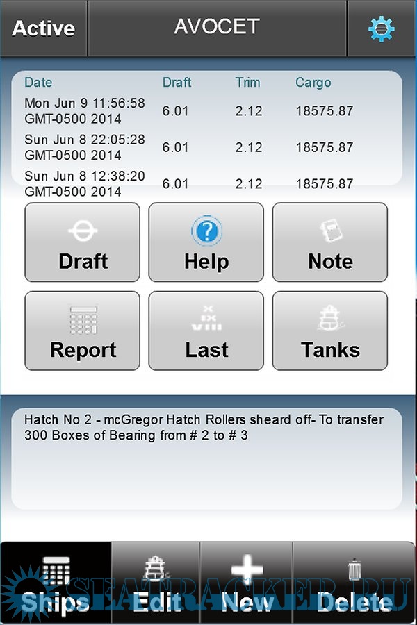

Draft Survey is a way to determine the weight of cargo being loaded on a vessel. Ship Surveyor App calculates the draft survey and produces a draft survey report.
This app requires internet if emailing report or downloading pre-configured ship.
THIS VERSION USES BOTH METRIC / IMPERIAL

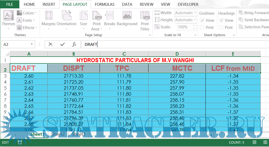

You can import your hydrostatic directly using Excel CSV format.
Just slip in the SD Card , USB with the CSV and tap Import while on Hydrostatic Screen.
You can configure the ship easily on http://draft.avocetdata.net using your excel worksheet.
Or you can email your Hydrostatic data in Excel format, CSV format or Text format to [email protected].
Please allows 3 hours before attempting to download. Please use correct Shipname and Callsign.
This service is provided FREE.

This app allows you to have multiple ships , email report and print report using any print app which can print email.
Pro Version has the following added features against its predecessor .
1- Email to multiple email addresses.
2- Instant Cargo Notes
3- Default Ship Selection
4-Ad Hoc Calculation. You do not need a HydroStatic Table.
5-Easy to use interface

I wrote tt this is impossible to use after installation bcs (as yr remark) there is necessary to input lot of data. And the second problem - it's not authorised by any Class. Finaly you may use it only for yr private reasons but not for official calculations. In case of any discrepency no one surveyor will pay attention for this calculated fugures.
By the way yr screenshot is Exel but not Draft Survey Pro.
aldrin226 ®   12-Dec-2015 15:15
friend, actually you can import the hydrostatic tables in excel to the app. yes this is not approved by any class but any prudent mariner would know to use it only as a reference. they will have no faith in an app like this. but this app has a potential like computers years ago. finally, dont you agree that having an app on handheld is better than opening a computer?
