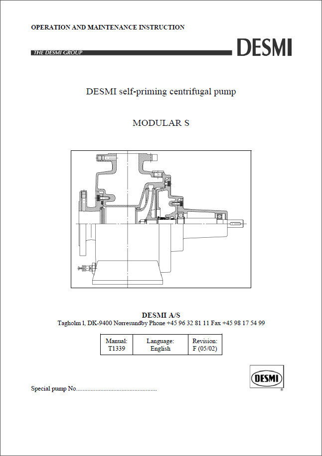

DESMI self-priming centrifugal pump MODULAR S / OPERATION AND MAINTENANCE INSTRUCTION
Year: 2003
Author: DESMI
Genre: INSTRUCTION
Publisher: DESMI A/S
Quality: OCR without errors
Number of pages: 20
Description: These operation and maintenance instructions apply to the DESMI MODULAR S pump series. The pumps
are available in sizes ranging from 25 to 100 mm on the pressure flange. The suction flange is bigger than the
pressure flange.
DESMI S is a single-stage self-priming centrifugal pump with stainless steel shaft and mechanical shaft seal.
The smallest pumps, S-32-25-110 and S-50-32-135, have open impeller, whereas all other sizes have closed
impeller.
The pump is suitable for the pumping of clean and polluted liquids with temperatures between 0 and 80°C.
With special shaft seal up to 140°C. Max. number of revolutions: 3600 RPM.
The pump has horizontal inlet on the centre line and vertical outlet at the top.
The back of the impeller is equipped with relief blades to reduce the load on the bearings.
Relief holes in the impeller ensure circulation of liquid for the shaft seal and prevent overheating of the shaft
seal during normal operation.
The pump is particularly suitable for the pumping of water in connection with e.g. cooling of diesel engines,
as bilge pumps, ballast pumps, pumps for irrigation, washing plants, air conditioning, cooling systems, and
sanitary systems, etc. Furthermore, in the majority of cases where the transport of liquid is required within
industry.

deflector are pulled off the shaft.
5.3 DISMANTLING SEAT
Press out the seat from behind the shaft seal cover (the bearing housing in S-32-25-110 and S-50-32-135).
5.4 DISMANTLING SHAFT WITH BEARINGS
Before dismantling the shaft with bearings, remove the sunk key (16). The shaft can now be pulled out of the
bearing housing allowing inspection of the bearings.
5.5 INSPECTION
When the pump has been dismantled, check the following parts for wear and damage:
- Sealing ring/impeller: Max. clearance 0.4-0.5 mm measured in radius.
(There is no sealing ring
in S-32-25-110
and S-50-32-135)
- Shaft seal/shaft seal cover: Check the seat for flatness and cracks.
Check the rubber parts for elasticity.
- Bearings: Replace in case of wear and noise.
6. ASSEMBLING
6.1 FITTING SEALING RING IN PUMP CASING
When fitted, the sealing ring is to bear against the shoulder of the pump casing.
6.2 FITTING SHAFT WITH BEARINGS
Lead shaft with bearings into the bearing housing. Fit sunk key (16). (Fit ring lock (30) and a new oil seal
ring (31) in S-32-25-110 or S-50-32-135).
6.3 FITTING WATER DEFLECTOR
Assemble the bearing housing and the shaft seal cover. Lead the water deflector over the shaft until it
touches the shaft seal cover and then further 1-1.5 mm into the shaft seal cover (the bearing housing in S-32-
6.4 FITTING SHAFT SEAL
Before fitting the seat, clean the recess in the shaft seal cover (the bearing housing in S-32-25-110 or S-50-
32-135). When fitting the seat, remove the protective coating without scratching the lapped surface. Dip the
outer rubber ring of the seat into olive oil (or another neutral oil). Now press the seat into place with the
fingers and check that all parts are correctly imbedded. If it is necessary to use tools for assembling, then
protect the sliding surface of the seat to prevent it from being scratched or cut. Lubricate the inner diameter
of the slide ring rubber bellows with olive oil and push it over the shaft. The use of a fitting bush as shown
on the assembly drawing is recommended to avoid that the rubber bellows is cut. Push the slide ring over the
shaft with the hand. If the rubber bellows is tight, use a fitting tool and take care that the slide ring is not
damaged.
If the carbon ring is not fixed, it is important to check that it is fitted correctly, i.e. the chamfered/lapped side
is to face the seat. The carbon ring can be held by a little grease. When using oil on the shaft, the bellows will
settle and seat in about 15 minutes, and until then tightness should not be expected. After start, check by
viewing the leak hole that there are no leaks.
6.5 FITTING IMPELLER
Fit the sunk key in the shaft and lead the impeller towards the shoulder of the shaft. Take care that the ring at
the end of the shaft seal spring locates in the recess of the impeller. Secure the impeller with a washer and a
nut.
Only S-32-25-110 and S-50-32-135:
Apply LOCTITE 270 or similar to the thread on the shaft. Screw the impeller towards the shoulder of the
shaft. Take care that the ring at the end of the shaft seal spring locates in the recess of the impeller.
6.6 FITTING GUIDE RING AND GUIDE VANE PIECE (ONLY S-32-25-110)
Place the guide ring (35) in the recess of the bearing housing. Fit and fasten the guide vane piece on the
guide ring. Note that the flat part of the inlet neck of the guide vane piece is to face upwards, i.e. opposite of
the drain passage for the shaft seal in the bearing housing. If the shaft cannot rotate freely, dismantle the
guide vane piece again, and place a shim (34) between bearing housing and guide ring.
6.7 FITTING BEARING HOUSING AND SHAFT SEAL COVER
Place the gasket between pump casing and shaft seal cover on the shaft seal cover where it can be held with a
little grease. Lead bearing housing with shaft seal cover into place and fasten. Note that the drain hole for the
shaft seal faces downwards.
S-32-25-110:
Place the gasket (21) between pump casing and bearing housing on the bearing housing. Check that the nonreturn
flap is placed correctly in the pump casing. Lead the bearing housing into place and fasten. Note that
the drain passage for the shaft seal faces downwards.
S-50-32-135:
Place the gasket (21) between pump casing and bearing housing on the bearing housing. Lead the bearing
housing into place and fasten. Note that the drain passage for the shaft seal faces downwards. If the shaft
cannot rotate freely, dismantle the bearing housing again, and place an extra gasket (21) between bearing
housing and pump casing.
6.8 SHAFT
When the pump has been assembled, check that the shaft rotates freely.
7. FROST PROTECTION
Pumps, which are not in operation during frost periods, are to be drained to avoid frost damage. Remove the
plug at the bottom to empty the pump. Alternatively, it is possible to use anti-freeze liquids in normal
constructions.
8. DISMANTLING
Before dismantling the pump make sure that it has stopped. Empty the pump of liquid before it
is dismantled from the piping system. If the pump has been pumping dangerous liquids you are
to be aware of this and take the necessary safety measures. If the pump has been pumping hot
liquids, take great care that it is drained before it is removed from the piping system.
9. START-UP
A self-priming centrifugal pump will not function until the pump casing has been filled with
liquid.
The liquid also serves as coolant for the shaft seal. In order to protect the shaft seal the pump
must not run dry.
WARNING
For safety reasons the pump is only allowed to operate against a closed discharge valve for a short time
(max. 5-10 minutes and at a max. temperature of 130°C). To protect the pump against unintentional
operation it is equipped with a relief valve, which opens at a preset pressure.
Be careful: When the valve opens, the escaping liquid will be hot.
The relief valve must in no circumstances be removed or re-adjusted !
As regards maintenance of the relief valve - see paragraph 11.
9.1 STARTING
Before starting the pump check that
- the shaft rotates freely without jarring sounds.
- the pump casing is filled with liquid.
Start the pump for a moment to check the direction of rotation. If the direction is correct (i.e. in the direction
of the arrow), the pump may be started.
10. SYSTEM BALANCING
It is often difficult to calculate a manometric delivery head in advance. It is, however, decisively important to
the quantity of liquid delivered.
A considerably smaller delivery head than expected will increase the quantity of liquid delivered, causing
increased power consumption and perhaps cavitation in pump and piping. In the pump the impeller may
show signs of heavy erosion caused by cavitation (corrosion) which may at times render an impeller unfit for
use in a very short time. Not unusually do similar erosions occur in pipe bends and valves elsewhere in the
piping system.
Therefore, after start-up, it is necessary to check either the quantity of liquid delivered or the power
consumption of the pump e.g. by measuring the current intensity of the connected motor. Together with a
reading of the differential pressure the quantity of water delivered can be determined against the
characteristics of the pump.
Should the pump not function as intended, please proceed according to the faultfinding list. Bear in mind,
though, that the pump was carefully checked and tested at the factory and that the majority of faults stem
