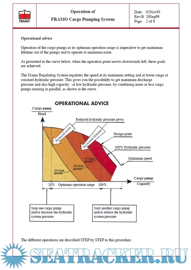

Description: Operation of the cargo pumps in its optimum operation range is imperative to get maximum
lifetime out of the pumps and to operate at minimum noise.
As presented in the curve below, when the operation point moves downwards left, these goals
are achieved.
The Framo Regulating System regulates the speed at its maximum setting and at lower range at
constant hydraulic pressure. This gives you the possibility to get maximum discharge
pressure and also high capacity - at low hydraulic pressure, by combining more or less cargo
pumps running in parallel, as shown in the curve.
